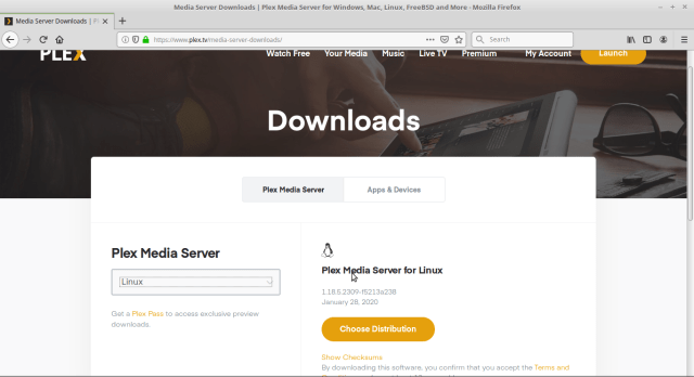

Para realizar la instalacion de plex media server accedemos a su web oficial de descargar https://www.plex.tv/es/media-server-downloads/
![[Image: 4-1.png?resize=640%2C348&ssl=1]](https://i2.wp.com/jungle-team.com/wp-content/uploads/2020/02/4-1.png?resize=640%2C348&ssl=1)
Nos descargamos la version linux para nuestro sistema operativo

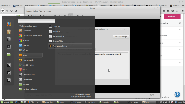

Realizando la instalacion del paquete descargado
![[Image: 7-1.png?resize=552%2C426&ssl=1]](https://i0.wp.com/jungle-team.com/wp-content/uploads/2020/02/7-1.png?resize=552%2C426&ssl=1)
[b]Primera configuracion basica plex[/b]
Una vez instalado abrimos plex en nuestro sistema operativo linux

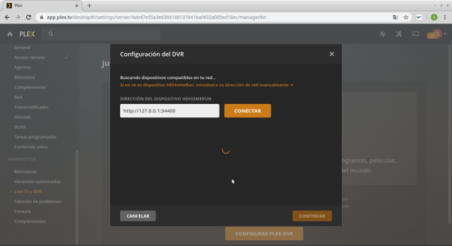

Ahora automaticamente nos deberia aparecer opcion tuner de nuestro receptor, pero si esperamos unos segundos y no aparece pulsamos sobre introducir url manualmente
![[Image: polla3.png?resize=640%2C348&ssl=1]](https://i1.wp.com/jungle-team.com/wp-content/uploads/2020/02/polla3.png?resize=640%2C348&ssl=1)
La url que debemos poner lo podemos hacer accediendo al portal web de xteve en la opcion DVR IP
![[Image: 1110.png?resize=640%2C348&ssl=1]](https://i1.wp.com/jungle-team.com/wp-content/uploads/2020/02/1110.png?resize=640%2C348&ssl=1)
En este ejemplo la introducimos y pulsamos en continuar

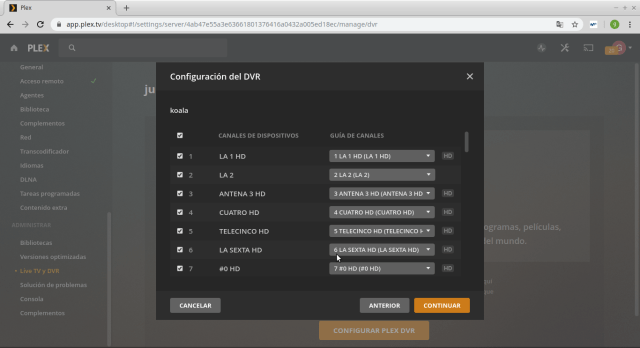

Ahora nos apareceran los canales de nuestro receptor, pulsamos en continuar
![[Image: polla9.png?resize=640%2C348&ssl=1]](https://i1.wp.com/jungle-team.com/wp-content/uploads/2020/02/polla9.png?resize=640%2C348&ssl=1)

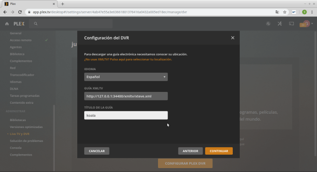

Introducimos la direccion de la epg koala
![[Image: polla12.png?resize=640%2C348&ssl=1]](https://i2.wp.com/jungle-team.com/wp-content/uploads/2020/02/polla12.png?resize=640%2C348&ssl=1)
Esta url la podemos sacar accediendo al portal xteve en la opcion epg
![[Image: 1050.png?resize=640%2C348&ssl=1]](https://i0.wp.com/jungle-team.com/wp-content/uploads/2020/02/1050.png?resize=640%2C348&ssl=1)

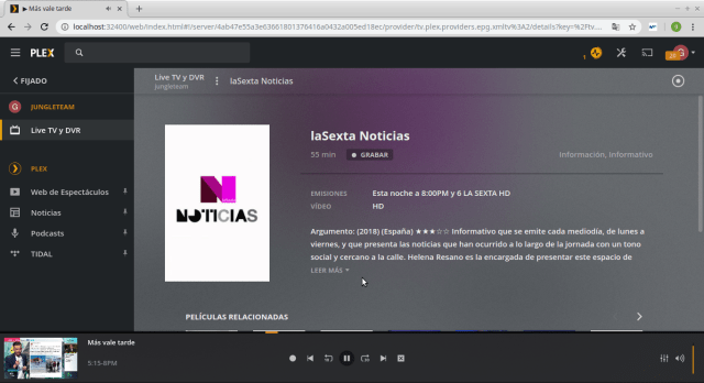

Pulsamo sobre GUIA si deseamos tener los canales ordenados
![[Image: polla201.png?resize=640%2C348&ssl=1]](https://i0.wp.com/jungle-team.com/wp-content/uploads/2020/02/polla201.png?resize=640%2C348&ssl=1)

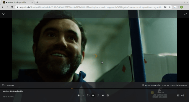

Y ya solo nos queda pulsar sobre el canal que deseamos visionar
![[Image: polla300.png?resize=640%2C348&ssl=1]](https://i2.wp.com/jungle-team.com/wp-content/uploads/2020/02/polla300.png?resize=640%2C348&ssl=1)
![[Image: pp.png?resize=640%2C348&ssl=1]](https://i2.wp.com/jungle-team.com/wp-content/uploads/2020/02/pp.png?resize=640%2C348&ssl=1)

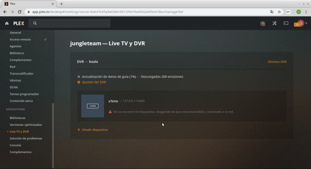

Creo que peor no me puede ir.... instale la última versión de ubuntu, la puse en español... instale las dos aplicaciones que salen en primer lugar del manual y cuando fui a instalar el plex media server, de las opciones que salían vi que había para la primera de opciones de instalar ubuntu (yo instalé la última) me voy a la configuración del linux station e instalo la primera, así me coincidían versiones y demás, (no quería problemas).
Me voy nuevamente a linux para hacer la instalación y veo que no tiene terminal. Me voy nuevamente a la configuración del linux station para volver a la ultima versión y ya no me deja hacer nada. no me sale nada para poder acceder a linux. solo se ve un botón de instalar y que al darle no hace nada.
Así que aquí estoy, peor que al principio, he reiniciado el nas, he desisntalado Container station, la he vuelto a instalar, he desisntalado e instalado como cuarenta veces el linux station y aquí sigo, delante del ordenador como un gili-polllas. (menudo domingo llevo). por todo lo expuesto necesito que me indiquéis cómo quitar todo rastro de linux en el nas para empezar desde cero.
Decir también que desee que he instalado y desinstalado Linux y todo lo explicado anteriormente me sale ahora este mensaje...
Que al darle a cerrar sale...
